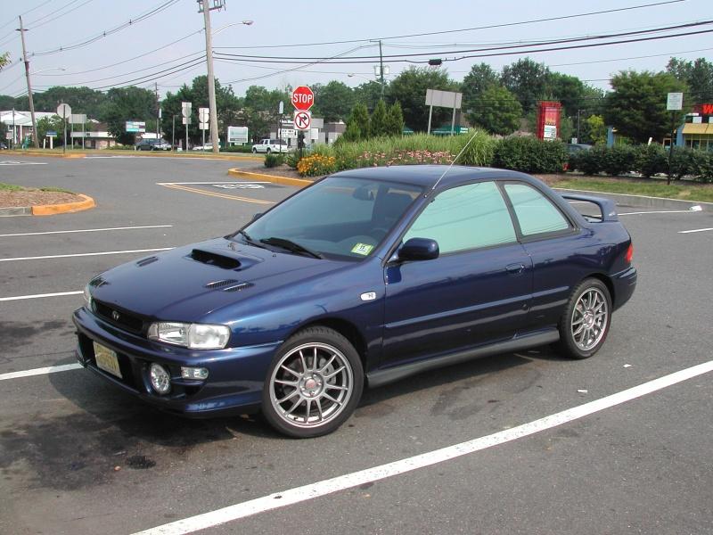

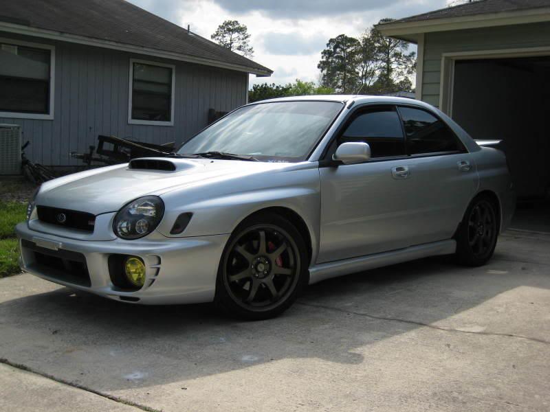

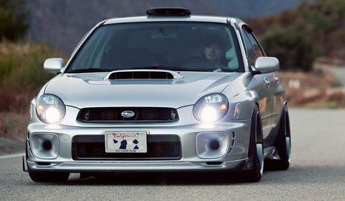

sparkyboy Posted January 29, 2018 Share Posted January 29, 2018 (edited) I retract my previous statements about the 2000 2.5rs being ugly I thought you guys had this horrendous thing And not this body style That is one of the best body styles for an sti swap The first gen legacy turbo would be my choice if I ever get a wrx or sti engine Edited January 29, 2018 by sparkyboy Quote Link to comment Share on other sites More sharing options...
