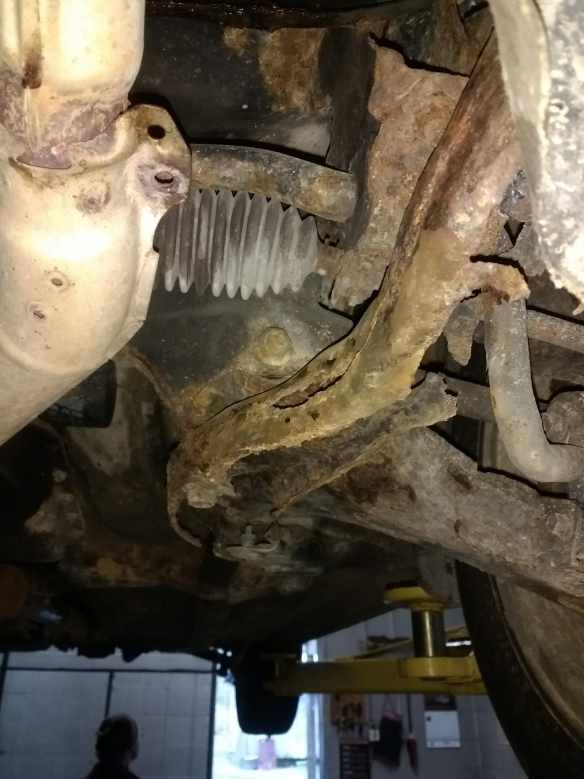

Gonna try to share some pics of it

I keep hearing that some just don't even bother replacing the U frame in question as it is a impact deflect related part of some sort...  But even if its not needed, control arms for a non highway robbery price would be awesome if I can find some..  New preferred, but man..  Its just not a common item apparently, or it's listed differently for some reason.

Yeah, the earlier models didn't even come with that u brace. Controls arms were under recall. It would be worth checking your vin number with the deaker and seeing if they've been replaced under the recall.
