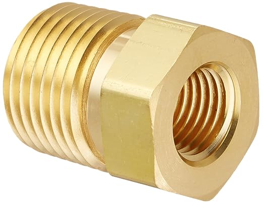

I used a piece of 3/4" rubber hose and put in a brass threaded bushing that would accept the PCV valve.  Put a hose clamp on either end (on on the tube and one on the bushing end).  The other end of the hose went to the tube on the JDM block.
