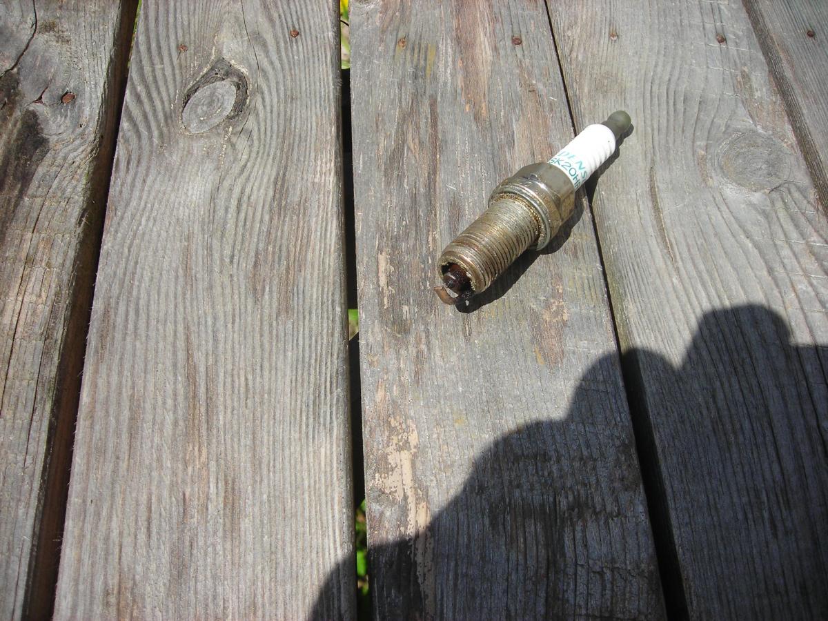

Really appreciate the offer but going to wait on tomorrow to see if the new plug does anything. The more I think about the problem the more fixated I get on a lean condition causing the problem. Today the weather sucked, snowing in KY in April WTH? Tomorrow and the rest of the week forecast to be nice again.
Great, glad you found an easy fix. Those engines love the stock plugs.
Every 100,000 mile H6 EZ plug I’ve pulled still looks awesome and I’ve never seen a misfire caused by stock plugs in H6s, they’re great plugs for simple reliability and low maintenance.
The plugs are easy to replace with the valve covers removed so I usually try to time VCGs and plugs at the same time on H6s which means I only ever do that labor job once. I guess if I can make 300k before rust gets it I’ll consider another change.
Great that you found the issue.  Interestingly I have had two vehicles both poorly running that ended up being a coil in both cases.  The 03 was getting constant misfires and check engine lights.  The 99 misfiring but no check engine light.  After doing all of the usual things ended up putting in a used coil and problem solved!
