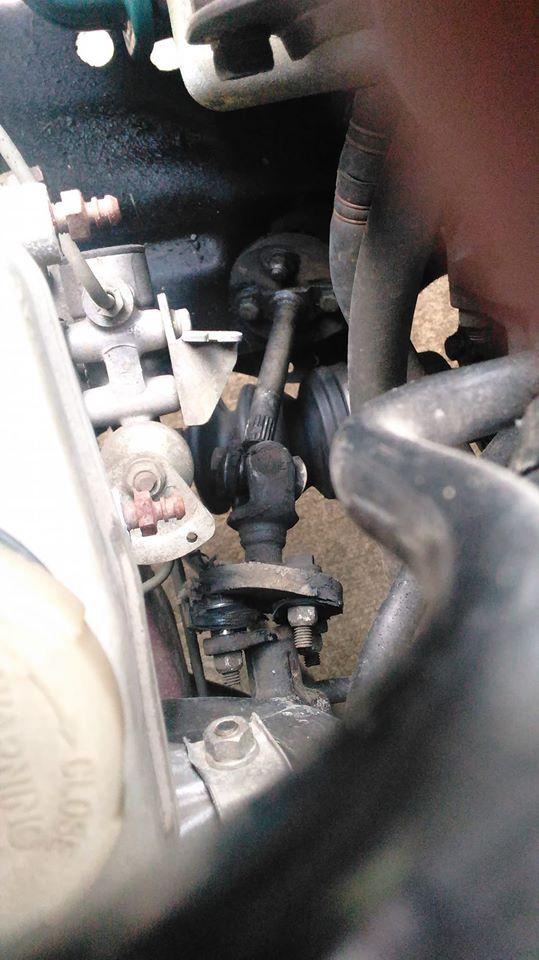

So I seen this the other day but had no one to turn the wheel for me. So I called my daughter over to help me and here’s the problem. 2 missing bolts on one side allowing the whole thing to slide back and forth and even pulling the casing out. Seems like a easy fix. Wish me luck
