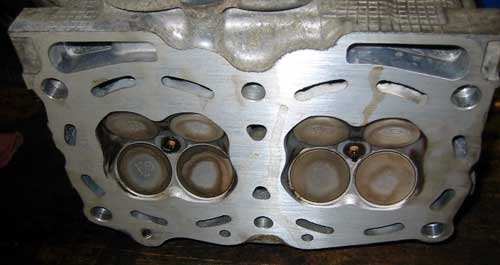

Ranger83 Posted July 10, 2004 Author Share Posted July 10, 2004 Image of head after machining. It turns out 0.004" out isn't very much for alloy heads. Quote Link to comment Share on other sites More sharing options...

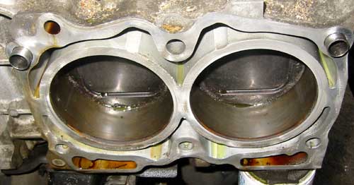

Ranger83 Posted July 10, 2004 Author Share Posted July 10, 2004 Image of block, before any cleanup. Quote Link to comment Share on other sites More sharing options...
