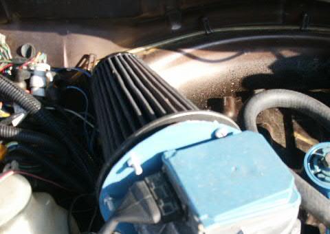

JWX Posted September 22, 2004 Share Posted September 22, 2004 ok I put my bottomless intake tray in my RX(the bottom part of the intake box) and I took out the two snorkels (I guess thats what they were) one above the filter and the one below. it sounds sooo much better. but I forgot to plug in the MAF before I fired her up, did I do any damage? and where can I get the maf adapter for a cone filter? Quote Link to comment Share on other sites More sharing options...
samo Posted September 22, 2004 Share Posted September 22, 2004 If it's for an EA82, the MAF adaptor from a 1991-1999 Nissan Sentra with the 1.6l engine (GA16DE) will bolt right up. You can get these at any rice/performance shop or on Ebay. A cheap one is $5, a nice aluminum one will run $30-$50. Quote Link to comment Share on other sites More sharing options...
JWX Posted September 22, 2004 Author Share Posted September 22, 2004 ok I edited mt first post so you guys know what I'm talking about. so the GA16 maf has the same bolt pattern on it, I thought it was a nissan one but I was thinking it was SR20. thanks Quote Link to comment Share on other sites More sharing options...
oobnuker Posted September 23, 2004 Share Posted September 23, 2004 Does this look like it will work: Ebay I had cobbled together a 'custom' adapter out of some home depot parts, but I need to replace the filter now. The one I originally used was a $25 APC unit from Advanced Auto. If this item on Ebay will work, it includes the adapter and a filter for $17.95 shipped... Quote Link to comment Share on other sites More sharing options...

samo Posted September 24, 2004 Share Posted September 24, 2004 That E-bay one looks a bit different than the one I had on my old wagon... but then again, that pic might not be of the exact MAF adaptor. If it's for a Sentra GA16DE, it'll work on our MAFs. Would people be interested if I could get a whole mess of these? I have some close connections in the Nissan community, and I might be able to snag some for cheap. Quote Link to comment Share on other sites More sharing options...
oobnuker Posted September 24, 2004 Share Posted September 24, 2004 That E-bay one looks a bit different than the one I had on my old wagon... but then again, that pic might not be of the exact MAF adaptor. If it's for a Sentra GA16DE, it'll work on our MAFs. Would people be interested if I could get a whole mess of these? I have some close connections in the Nissan community, and I might be able to snag some for cheap. I took a look at a bunch of their other auctions and they use the same picture for a lot of them...So let's hope it's the right one. Quote Link to comment Share on other sites More sharing options...

calebz Posted September 25, 2004 Share Posted September 25, 2004 Aluminum can be had from autozone for $15.99 .. Thats what I have on my car. Quote Link to comment Share on other sites More sharing options...
