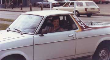

Seahag1978 Posted October 19, 2004 Share Posted October 19, 2004 hmmm... my "new" '78 4 headlights silver trim on the dash top center ashtray, unlighted no tach no wheel well trim no side molding sunroof? vinyl seats ?? radio?? it's a Sony aftermarket white spoke wheels One odd thing, my original '78 only had an AM radio, no cassette and side molding, silver wheels (not spoke), blue interior, vinyl seats, roll bar in black... the picture here is the original model, completely stock... I guess I never knew DL from GL? Quote Link to comment Share on other sites More sharing options...
