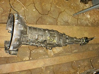

Heres a pic of a tranny. sorry no dimentions.

i have a 4sp 4x4 spare i could measure that if u want

I can see the point of using the RX7 trans...no front diff/axle stubs to mess with...and in my case with the RX, no center diff lock to worry about breaking and then be stranded cuz of no front axles.
Looks like you could simply set the RX7 trans in where the suby is stock and the shifter would be right were its supposed to be stock.
