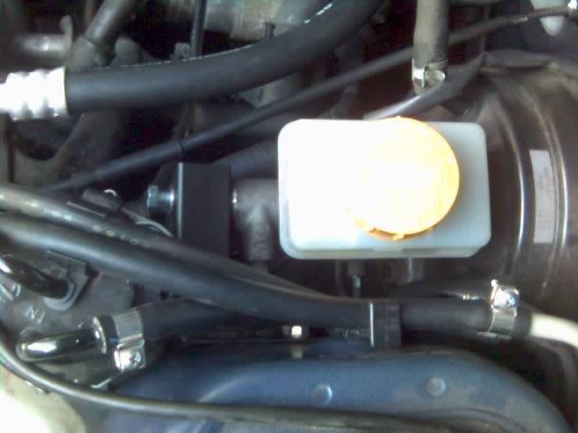

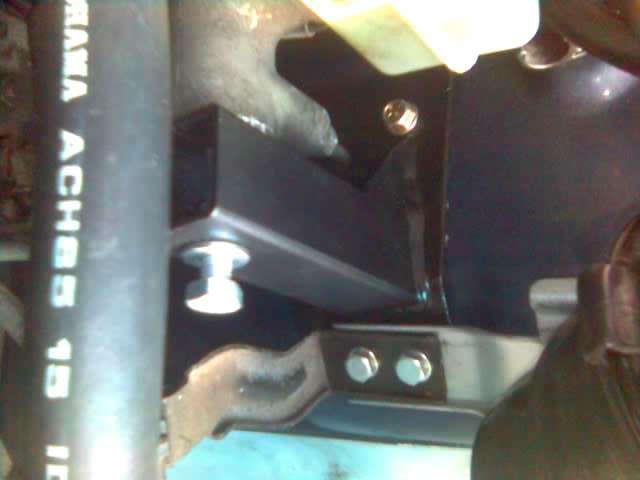

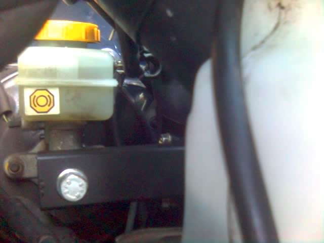

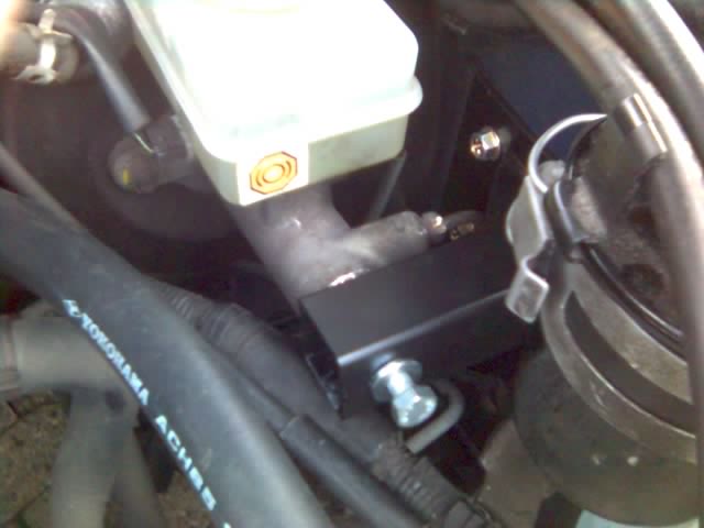

Setright Posted October 18, 2004 Share Posted October 18, 2004 Ever since I sold my Legacy BC7 and bought an Impreza I have been yearning for the firm brake pedal of the first car. Reading around the internet and talking to a driving-instructor who also drives an Impreza, I discovered that the main culprit is the firewall. It's too thin and flexes in concert with the brake pedal. So, my plans to replace the brake hoses with steel braided items, and maybe replacing the drums in the rear, were ditched. And I made this master cylinder support myself. Inspired by looking into the engine room of my girlfriend's parent's Mercedes. And the darn thing works! Pedal is firm and responsive :-) I would strongly recommend this mod to anyone. Take note that no new holes have been made. I will gladly take a few more photos if someone wants to copy this design. Quote Link to comment Share on other sites More sharing options...

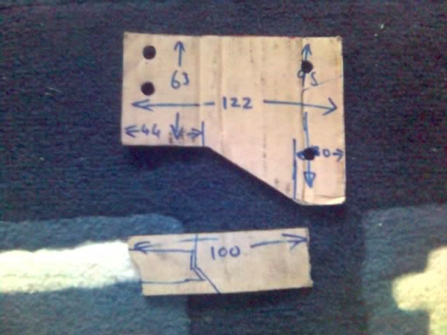

Setright Posted October 19, 2004 Author Share Posted October 19, 2004 In essence: A 3mm thick steel plate, bent to fit around the suspension turret. Drilled four holes to match the two that hold the fuel filter, and the two at the back that were not occupied. A 30 by 30 mm square pipe welded on just where the plate bends, so that it reaches out in front of the MC. The pipe is supported by an extra triangle of 3mm plate, mounted only on the top, there is no room below. A hole drilled through the pipe allows a bolt to go through, there is a lockning nut hidden inside the pipe. This setup allows a little "pre-tension" to take up the slack in the system. Quote Link to comment Share on other sites More sharing options...

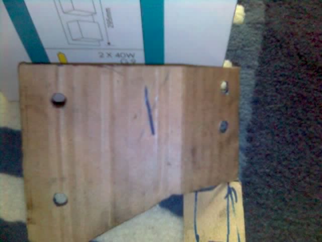

Setright Posted October 20, 2004 Author Share Posted October 20, 2004 Okay, this morning my IBM and Motorola decided to be friends again, and the photos are here. To all those who are dissing this mod, quit wasting your time here and provide something positive in another thread please :-) I hope these cast enough light on the matter. "Pipetilt" is included to demonstrate that the square pipe is rotated slightly to make the bolt hit the MC at 90 degrees. (blue line indicates angle) The measurements on the cardboard templates are mm, and not 100% accurate. Expect to do some customising... The only thing I needed external help with was the welding, mainly because I don't have the equipment! I painted the bracket in two layers of primer and four layers of semi-gloss black. Hopefully, that will stop it rusting and ruining looks. Quote Link to comment Share on other sites More sharing options...
subeman90 Posted October 20, 2004 Share Posted October 20, 2004 Once again let me say.... I love it! You did some very creative and good work in my opinion.... thanks for the pics too! The metal you used for the mount plate... shouldn't that be a little thicker or is it ok the way it is? Great job. Matt Quote Link to comment Share on other sites More sharing options...
Setright Posted October 20, 2004 Author Share Posted October 20, 2004 Thanks! 3mm is plenty! 2mm would do the job, but I like to increase the margins. The pipe itself has 2mm walls, but there are two in each direction :-) 3mm is also nearing the limit of what can be bent accurately, without a machine. Quote Link to comment Share on other sites More sharing options...
