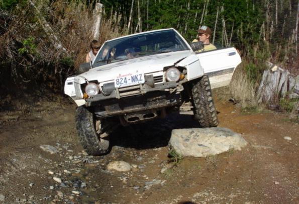

I have a Mud Terrain tire that isn't on the tire list.
Hankook MT RT01 215/75/15
Off Road **** On Road ***** Tread Life ***** Price *****
Off Road these tires rock. I've taken them through thick mud, snow, gravel and yes even rocks. They have really good mud terrain lug pattern that will grip any condition except Ice of course. On road these tires are amazing. They are specially designed to be very quite on road. I can't even hear until I take a high speed turn. The tread life seems pretty good. Even during a hot summer I rocked them and they didn't wear very much at all. Maybe that's because they were made for a heavier truck not a light grocery wagon. They are made of a harder rubber than the swampers. They arent as wide as the swampers, but they rule on a suby. An awesome tire for the price. Also optional studs.
