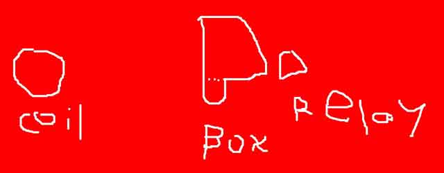

#6 subiemech85
subiemech85
    SIX STAR SERVICE
  • 2,710 posts
  • down by the river
Posted 20 November 2004 - 10:52 PM
pop the tab that is on the bottom of the grey cover with your finger as you pull straight up the tab is on the coil side, see diagram
