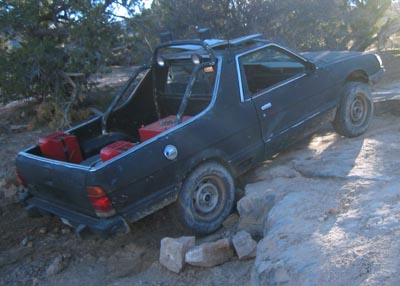

Since Wasteland is MIA, here's a lousy pic of his brat & fuel cell.
I think thats a killer pic!

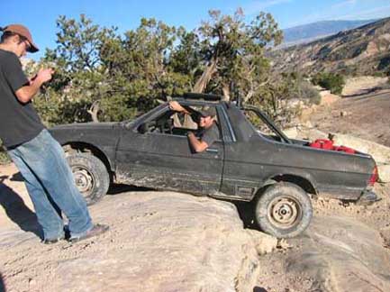

nice brat.. big rock.. did u let it go back down or is that the fuel cell starving the engine causing you to go down..?
*cough*
The FI wagon didn't have any problems....:D

Soo....Did you ever make it up the hill/cliff? :rolleyes:
That looks like Moab country!

I never made it up, in fact I hung up on my frame rails because the Brats not lifted and had to be pushed off backwards. Fuel starve was the main problem on the first try though. Problem is, if I rally with too much fuel in the cell, it tends to weep out of the vents when I highside or hit the step stuff. It's just a matter of finding the right fuel level for rallying.
