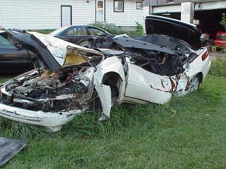

Exare Posted January 10, 2005 Author Share Posted January 10, 2005 All good info..though the SVX does not have cap/rotor/wires, it has direct ignition on each plug. Tranny issue is probably the biggest worry, but add a good cooler, and it should survive. In the SVX pictured below, the guy survived. Yeah they are crashworthy...extremely so. Just a note, you can replace the tranny with a legacy one if you change the rear differential to match. 5-speed swaps are also common and not incredibly difficult. Good luck, and check out www.subuaru-svx.net/forum for the most SVX info you'll find. I didn't post my above reply until after you got yours in,. you sneaked under me while I was writing it c_c. lol. How much do coolers and transmissions go for? That car is trash! That's nuts! I'm glad to know it's a safe car^_^. Thanks for the link! I'm checking it out now:). Quote Link to comment Share on other sites More sharing options...
