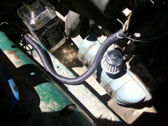

so i got the weber hooked up but its still diesling and backfiring really loud and ive done almost everything i know to do from clean the top end , adjust timing ,lean out fuel ,ect and i have the hoses off the valve covers hooked up with little filters heres a pic. i was wondering if i should hook them up to each other with a tee and one filter or how they are? or if it will help . any sugestions on how to fix the backfire dont care so much about diesling .thanks

You have filters on both valve covers? One of them needs to be hooked up to vacuum and a PCV valve. On mine, the drivers side is to the PCV, and the passenger side is vented in the air cleaner. Do you still have your emissions doodads hooked up? If so, air being added to your exhaust ismprobably causing the backfire (my best guess). I've read that if you have an exhaust leak, they'll backfire too. My nasty backfire was emissions equipment related though.

ya my exhaust is the stock exhaust haha it was the stock spark plugs in it , ran great but the exhaust has a leak every four inches..... but also all emissions are gone . so im hoping its exhuast?
yeah probably? I plugged up my emissions stuff, and repaired my exhaust at the same time, so I don't know which fixed it. :drunk:
