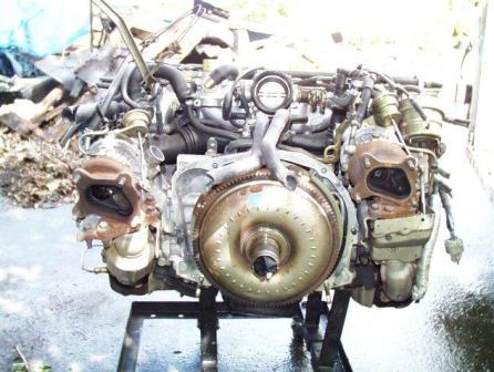

when they work, they work pretty well. putting down all the power of your standard EJ20t (a nonspecific term to reference any single turbo 2.0l EJ engine), with very little lag. because the smaller turbo spools almost instantly. in stock form, they leave a hole between where the smaller turbo peaks and the bigger one is just beginning to spool up, but I think some tuning and exhaust work, coupled with some carefully selected turbos, you could eliminate this.
East Coast Swappers just finished putting a complete, stock EJ20H into an impreza (converted to RHD....of course). some cool info on it....I'll try to find the link.
but yes, the extra complexity does sacrifice some reliability, but so does a single turbo over N/A. sometimes a price worth paying.
edit: added a pic of an EJ20H that I had saved on my computer
