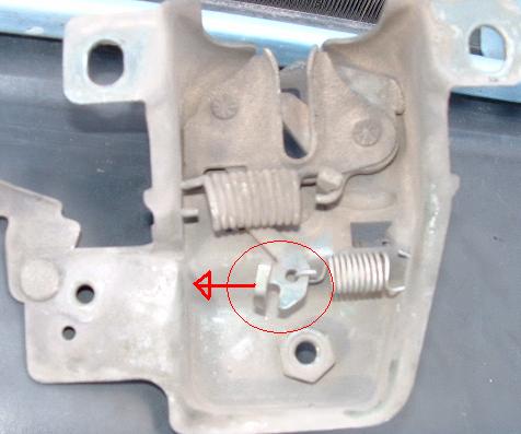

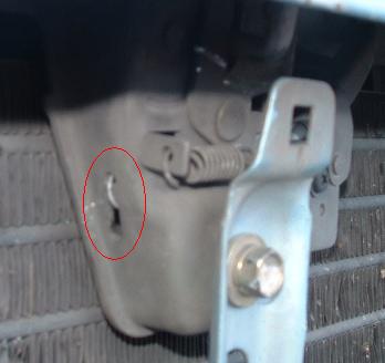

hooziewhatsit Posted February 23, 2005 Share Posted February 23, 2005 ... without breaking anything (else) I had this experience a couple days ago. Pulled the cable under the dash to unlatch the hood, and it pulled out :hangbang: After reading some posts where grills got destroyed on the path to opening the hood, I figured there should be a better way. So, off to the junkyard I went to figure out how they work. What I came up with took me about 30 seconds to do, and leaves the grill intack. The first picture below shows the latching mechanism from the back. We want to push the latch that's circled to the right (yep, follow the arrow). To make this easier, we'll undo the spring that pulls it left. The second picture shows it from the outside. Procedure: 1. I used a small flat head screw driver to pop the spring out. The spring promptly disappears back into the mechanism, which is fine; it's out of our way now. 2. Use the same screw driver to push through the hole the spring just went in to. I was able to do this with some fingers through the grill, and the other up from the bottom holding the screwdriver up. As you can see from the first picture, the screwdriver needs to go in straight and level. Some down pressure on the hood from a helper might also take some pressure off the latch to make it easier to release. When you hit it correctly, it should clang like it usually does and release the hood. Alternative method: If your mechanism does not have a plastic backing on it. (Maybe they all do, my loyale didn't though). You may be able to reach up from the bottom with a long box-end wrench and grab the hook. You need to use the box end so that you have the right angle to catch it. Hopefully this helps keep someone from needlessly destroying a grill if this happens to them. Or this could just be a reminder to go check all of your cables for fraying :beer: keywords: hood latch stuck broken cable 3 Quote Link to comment Share on other sites More sharing options...

hooziewhatsit Posted February 24, 2005 Author Share Posted February 24, 2005 When my cable broke all i had to do was reach up under the bumper pop off the plastic back and grab the latch and pull with my finger.Pops open as easy as if the cable was still working ! Do you have A/C in your car? If you don't, I presume the AC radiator wouldn't be there, then there would be plenty of room to open it that way. All the cars I looked at had the AC rad, so there wasn't enough room to even take off the plastic bit. Quote Link to comment Share on other sites More sharing options...

torxxx Posted February 25, 2005 Share Posted February 25, 2005 EA82s should all be open. All the ones I've seen at work have been. For us skinny guys, reach up from under the bumper on the drivers side of the center support (where the hood latch is) You'll feel the arm with the spring on it. leave the spring on, just pull on the lil arm stickin out. hehe, I did that for two years until I broke my grill out jumpin through snowbanks. Quote Link to comment Share on other sites More sharing options...

torxxx Posted April 18, 2005 Share Posted April 18, 2005 yup thats the best way to take care of it. Use the broken cable since it breaks at the release itsself, pop the release spring off on the passenger side of the release and then reach up with a long flathead screwdriver and hit the release lever ont he right side of the release mechanism. Unbolt the mechanism, tie the old cable to the release, run the wire across the car, thread it through the top of the marker light between that and then fender and then tie a lil loop on the end. heh, I've had to do that to 4 cars at work this week. ran out of spare good release cables. Quote Link to comment Share on other sites More sharing options...
