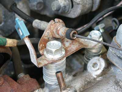

ok man, nonsence huh? my 20 washers works great. instead of making some bracket out of steel, i just move the stock bracket up 1 inch with longer bolts. works great, solid as hell, and just like stock. dont knock it till you try it skip!

Posted 28 August 2003 - 06:43 PM
like this

sorry Arche, I didn't mean to dis your fab, little more explaination would have been kewl though.
Thanks for the pict looks like a nice set, have you thought of replacing the washers with short pipe nipples?
I don't know if this will work on an EA81 engine though, the throttle cable needs offset toward the drivers side.

The 32/36 weber is designed for 1.5L to 2.0L engines so you should be okay. Jetting might need to be modified from the EA 81. archemitis, what did you rig up for the throttle return spring? I like you 20 washers and wonder if you have a similar neat and simple idea for the return spring.
