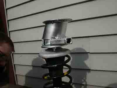

archemitis Posted March 1, 2005 Share Posted March 1, 2005 hard to make, and even harder to find a picture of on the web. seems to corect camber, just like it should. its a 4 inch lift. had to bash the inner fender pretty good. tires sit like they should, this is my first try at it... i have ideas for better ones, but im runin this one for now. straight custom! Quote Link to comment Share on other sites More sharing options...
monstaru Posted March 1, 2005 Share Posted March 1, 2005 is that a shock mount on the side? that looks pretty good .....tell us how it is in action Quote Link to comment Share on other sites More sharing options...
northguy Posted March 1, 2005 Share Posted March 1, 2005 Looks like it should work just fine. Quote Link to comment Share on other sites More sharing options...
Jibs Posted March 1, 2005 Share Posted March 1, 2005 Here's an all-right pic of a BYB kit strut extension: Now I'm not condoning the use of this to copy his ideas, I know most of us wouldn't think of it, but I jad to say it:) Yours looks great though, I'm sure it'll work! Great job! Quote Link to comment Share on other sites More sharing options...
archemitis Posted March 1, 2005 Author Share Posted March 1, 2005 thanks for posting that, never seen an ea81 one up close. that byb one is pretty much like mine, cept i did the bottom differently, cuz my ban saw broke, after i made the top two plates my dad swears you dont need it, he thinks longer shocks will work, but he dont get it. i told him he could try it on his rig, but not mine. Quote Link to comment Share on other sites More sharing options...

one eye Posted March 2, 2005 Share Posted March 2, 2005 Thats was the worst part for me too. I had to replace the struts a while back and had to grid every thing all overe again to get it all back together. It sucked Jeff Quote Link to comment Share on other sites More sharing options...
archemitis Posted March 2, 2005 Author Share Posted March 2, 2005 ya, thats why i avoided welding anything to the strut cap. Quote Link to comment Share on other sites More sharing options...
monstaru Posted March 2, 2005 Share Posted March 2, 2005 soooo,IS that a shock mount on the side or what?if it isn't it should be:brow: Quote Link to comment Share on other sites More sharing options...
Roobaflu Posted March 11, 2005 Share Posted March 11, 2005 how do you figure out the plate angle so you get the right camber??? Quote Link to comment Share on other sites More sharing options...
archemitis Posted March 11, 2005 Author Share Posted March 11, 2005 i believe its 7mm of ofset per inch of lift.. or 20-22 degrees for a 4 inch lift. i'll have to look at my notes to be sure though... im very bad at remembering numbers... a spark plug is gapped at .4 right jk Quote Link to comment Share on other sites More sharing options...
