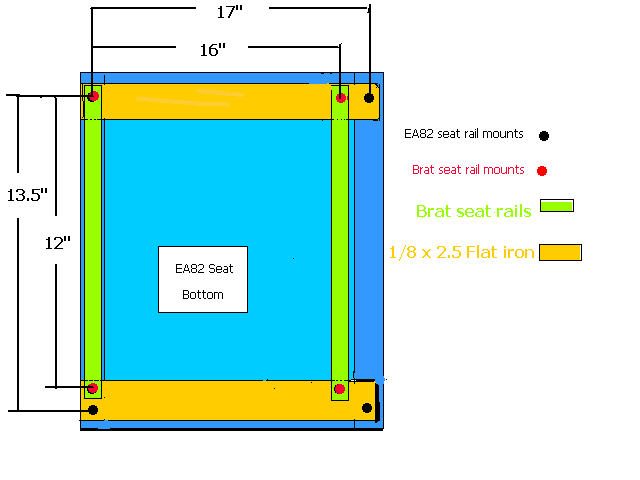

I put the seats out of a 87 3dr in my brat. The (4) mounting holes on the 87 seats are about 1" wider and longer than the Brat seat rails. What I did was cut some 1/8 x 2 1/2" flat iron and bolted that across the 3dr seats and drilled holes for the brat rails to bolt too. Worked great.

Thats a lot more work than you need to do. Some people don't like welding inside a car or have a welding machine. Here is a simple diagram of what I did.

I think my design may be stronger than the one in "Helpful Diagrams" But both would work, without welding.

I looked at legacy seats a few weeks back at work. They are wider railed seats, so you'd have to make the adaptor everyone is talkin about. I think you could get away with usin 1/8 inch flat bar steel. measure everything up, and just have a machine shop cut and drill it. then bolt her up

I don't know about a machine shop. I did mine with a hacksaw amd a hand drill. Your not building a Swiss Watch.
