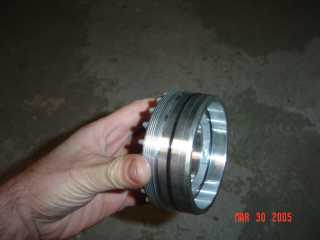

Ok, so here i am again.Guys can you please tell me how replace two sealings around transaxle studs? I just pull out old tranny and pull old studs but i need replace those sealings.They are from inside.So how to do this.The old ones are damaged.I tried remove the ring on the old tranny. It seems to hold in place by one bolt.Removed bolt but it still holding in place.
Help please......

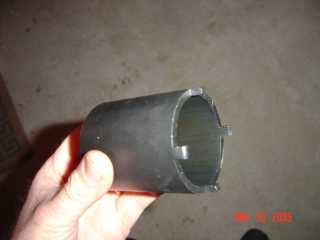

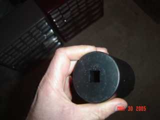

After removing the one bolt and retainer clip, the whole circular "teeth" retainer will spin off counter clockwise. You may need to buy a special spanner tool to remove it, or a truck spindle socket (see pic) or use a screw driver to catch two of the teeth and loosen. Mark the retainer to a reference point on the transmission or count the number of turns when you remove it. It must be reinstalled to the exact same depth, since there is a bearing race on the inside of the retainer.
You will need a new seal and a large o-ring pn #806730031.

Pull only one side at a time. Replace the seal and O-ring, lube the outside with light motor oil and carefully spin it in by HAND. The threads are very fine and can be cross threaded, Make sure the threads and bores are clean and free of any damage. Spin the assy in as you go so it does not cock in the trany. As pointed out mark a alignment point on the trany and housing.
