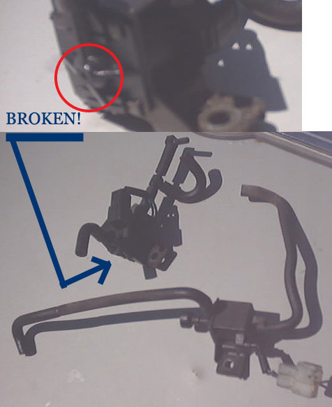

I've attached a picture of the two solenoids from the SPFI donor motor I put in Skeet's car. I apologize for the wait.
One has a black wiring harness clip and the other has a white one. the black one has a vacuum snout broken off as indicated. I don't know which is which.
I also have an SPFI wiring harness, and an EGR valve that I could sell too. Maybe you have something further upstream or wrong with the EGR valve itself? Interested?
