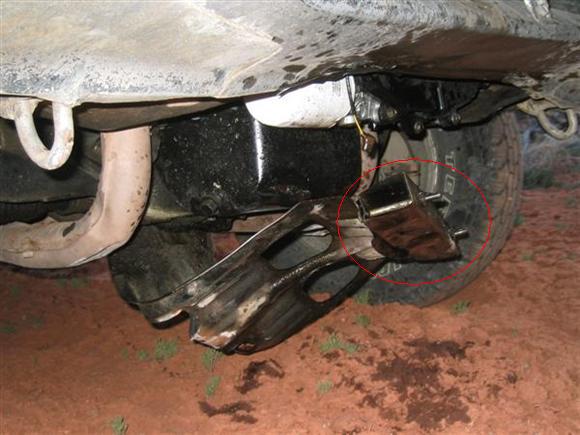

after seeing that oil pump ripped of. i realy like the idea of putting a spacer in the rear of the skid plate, not the front...
I redrilled the spacer and stuck it back on with 3 14mm thread bolts and big ol' washers; it's definetly stronger now than it was. Neccessity is the mother of invention, as the original mounting point/capitve nuts no longer exist. :drunk:
Her's my plan though, since EA82s have the swaybar in front of the control arms.... I removed the sway bar long ago, and it left two solid mounts on the cross member... I'm going to build a chin guard off those mounts that should be able to cover the y-pipe. I might even be able to incorparate a bushing in there to suck up future impacts.
actually, if you were to attach the skidplate on the front as normal, you would need to just re-drill some holes in the plate it attaches to. the new holes will be more forward from their original position...
but by doing that, the skid plate will now be very close to the oil pump, if not hitting it or the filter. in the pic posted with the twisted skid plate, the pump is still intact.
that pic looked like ramming speed was involved :) if the skid plate had been on without a front spacer, I think there would have been oil pump/possibly engine damage from an impact like that...
if your gonna be rammin', better off with a full skid plate :)
It was like 2nd lo, I swear! Seriously, I just caught it at the "perfect" angle. It's not like I was going fast enough to spill my beer or anything. :drunk:
Definetly took out the pump though, snapped the pressure sender off and took a piece of the pump housing with it. Also cracked a T belt cover, bent the pitch stopper, dented the pan, and totally polluted the trail. :-\
Anywho, I tried to set mine up without the spacer when I fixed it, and the plate was touching the pressure sender and oil pan. That's no good, it's not doing jack then. Even with the spacer there's only like 1/2" of clearance in there.
