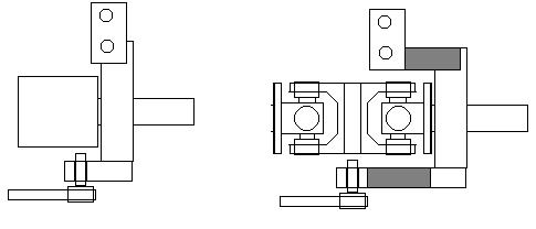

I am thinking of something like this for my kunckle mod.

Looks sorta like what I was thinking of doing with Datsun axles. Main problem seems to be with heat treat and welds.

Those are all driveshafts; not axle shafts. There is a company that makes extreeme angle axle shafts with very tough CV joints. These companies can surely make what is needed for a Subaru but nobody want's to pay for what they are worth.
We'd prolly have full 6" suspension lift kits by now for Subaru platforms; but people whine about paying $400 for a simple 3" body lift. People pay thousands of dollars for suspension lift kits on other vehicles and that's why they have aftermarket support.

Looks like a regular old Double Cardan joint. Can be found on the front of many Jeeps, esp. Cherokees.
Go to the local J/Y, snag a few front drive shafts from Cherokees, break out the welder and tell us how they do as axles on a Sube.:drunk:
