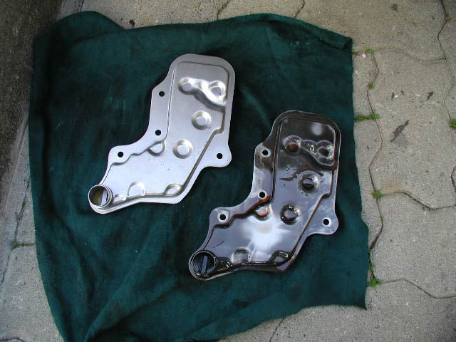

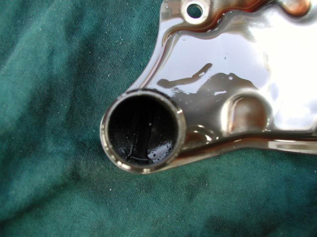

ShawnW Posted October 21, 2005 Share Posted October 21, 2005 I hate to hijack this thread, but I have a similar question, but different equipment. I have a 1998 Legacy Outback 2.5L Auto 136200mi. Is there a tranny filter...? ...internal, external, both? I just got the car and would like to put in new fluid. All advice is appreciated. Heres as complete as I care to add but also answers your question. Its certainly not hijacking you are asking a followup to the original thread and this keeps pertinent information in the same thread for better future search results. I appreciate your following up on the same thread. Theres a screen in ALL of these EJ Automatics. The guy that posted a photo above with the dirty one shown on the right is it, found inside the trans pan and secured with 8 bolts or so to the valve body. Be sure to not damage or lose the o ring on the filter when changing it out. Its my opinion that theres no reason to open the trans pan and clean this unless your transmission is demonstrating symptoms similar to lack of fluid flow or you are doing a shift kit installation (well worth it). The side filter starts 6/98 or so and looks just like an oil filter only smaller than the Oil filter found on a Legacy. Its usually black and threaded horizantally to the transmission on the drivers side on USA and LHD models. The factory trans filter is all I would EVER Recommend. They are around $30 MSRP from Subaru and only need changing at 45-60K intervals. A 98 Outback would be the earlier 4eat EJ transmission and subsequently has no screw on filter and the external one on the frame rail DOES NOT FIT ANYTHING WITH AN EJ25 so you dont have one. Ej22 equipped cars from 90-97 MAY have the external filter kit installed. It runs off the radiator down to a black filter bolted to the frame rail below the battery and runs back to the transmission lines. Its a great add on for anybody that has an ej22 and can be ordered from the dealer as a recall kit for a VERY reasonable price. Quote Link to comment Share on other sites More sharing options...
nipper Posted October 21, 2005 Share Posted October 21, 2005 Sorry about the "dude" thing, i didnt know u hate it... You should do what you think its good for you and your car. Im saying that this screen has to be serviced 40-80K Km - and by saying "serviced" i meen that this filter has to be cleaned (not replaced) and reinstalled. Somtimes this screen is damaged (cracked) and its bad for the transmission. Only when its damage - its need to be replaced. If you really want to take car of your transmission, clean this screen every 80,000km (what you see in the pictures upstairs is a 83,000km filter that never been cleaned before). Itzik tis OK Update on my OBW. Two weeks ago i got the tranny flushed at 180K, the AWD was showing torque bind, and it was shifting very hard on the 1-2 shift Its been two weeks. The 1-2 shift has smothed out, andthe torque bind is gone. nipper Quote Link to comment Share on other sites More sharing options...
