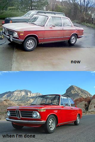

Regarding my near future move to Tucson... Obviously, I need to drive there. I have a 1972 BMW 2002 weighing about 2200 lbs that I am not willing to part with. That, plus a few things I own, not more than 150 pounds total I think. Renting a truck is out. I would sell the GL and drive my bimmer, but the engine is tired and smoking, I'm afraid it would leave me stranded. So, can an 83 GL with 15 inch tires and couple hundred pounds tow? I just read a thread about running in RWD. Of course that would be better than FWD but could I damage something doing so?

Well, honestly, because EA81s are a dime a dozen and 2002's aren't. I'm afraid someone would cut my baby up if I sold her, I'm just too attached (I talk to my car). If I did buy a truck I would most likely sell it when I was done and get a hatch or something anyway.

The BMW would almost certainly not make it. Previous owners have not taken care of it, and before I learned what "oil pressure" was, neither did I, so the engine smokes like Dennis Leary having a mental breakdown. I would like an 80s Toyota truck with the 2.4 or something similar, cheap to run and reliable enough to drive around AZ until I find a good car. I exepect to leave in about 6 months... *maybe* I leave my apartment in 30 days to live with my mom (should save me about $350 a month) and will leave when I have twice as much money as I expect to need and then some. I have taken 2 trips to AZ in the past to scout out living areas and have run out of money both times; I want to be fully prepared this time.
