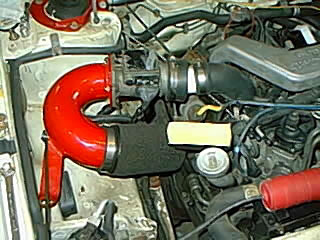

subiemech85 Posted November 29, 2005 Author Share Posted November 29, 2005 I got creative and made my own! it only cost $ 10 for materials 3"x2" reducing bushing 1-1/2" pvc coupling 2" flexible elbow also added the pcv filters and hooked up the yellow line for wastegate Quote Link to comment Share on other sites More sharing options...
subyrally Posted November 29, 2005 Share Posted November 29, 2005 looks like what i used, only reccomendation on that would be to move the rubber hose from direct contact with the turbo. get a stock intake hose if you can find a spare, and put that at the turbo inlet and then get a 2" threaded pipe union thingy to connect the two hoses. i hope that makes sence to you, it did in my head, but ive only been awake for like 15 minutes now. Quote Link to comment Share on other sites More sharing options...
