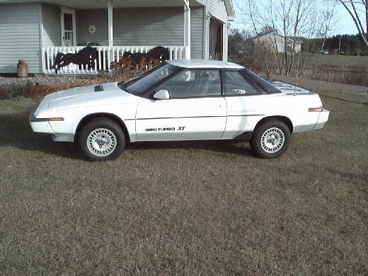

Posted 26 January 2006 - 10:35 AM
He is one with just the strut lift and 14" pugs
