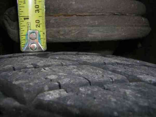

MountainBiker Posted March 10, 2006 Share Posted March 10, 2006 I've seen lots of posts about putting Forester or Outback struts on OBS and IMPs, so does that mean I could fit Legacy Outback struts on my Forester? I have oversized tires, 215/65-16 (27.0") Pirelli Scorpion ST, and they have only about 4mm of vertical clearance from the spring base on the rear struts! (see picture) I'm thinking that the OB struts will provide more clearance for larger tires, since various reports here say that 29" tires will fit. It would be real easy for a rock to get wedged in there and cause some damage. I'm at the point where I need new struts, so now is the time to find out if this will work. And if I get a little extra lift while I'm at it, even better! What years of OB struts have the best chance of fitting on my 2002 Forester? Quote Link to comment Share on other sites More sharing options...

MountainBiker Posted April 10, 2006 Author Share Posted April 10, 2006 I was able to get a hold of KYB struts for the 98-02 Forester and the '96 Outback. You can view my measurement results in the attached file. It appears to be possible to use the Outback struts on the Forester (might need different top hats). Doing so would give more tire clearance to the rear struts and more height, due to the longer rear Outback strut length. Tire clearance was the reason I looked at the Outback struts, but the fit issues and the decreased stroke make it not worth it for me. Anyone with an Imp wanting a lift, I'd suggest you go with the Outback struts if you are considering getting large tires. I've also observed that '03 + Forester struts have more clearance too. strut.pdf Quote Link to comment Share on other sites More sharing options...

MountainBiker Posted July 5, 2006 Author Share Posted July 5, 2006 Well, I did get a rear '04 Forester strut. It does have more tire clearance than the '02 F'ster rear strut, and just about identical tire clearance to the '96 OB rear strut. The '04 Forester strut is also a little longer, so it would have lifted the rear of my '02, but it unfortunately has less travel! I'm not willing to sacrifice travel (articulation) for tire clearance, so I went with new KYB GR2 struts designed for my '02 all around. Got them mounted up at the same time I installed the SubaXtreme lift, Woo Hoo! Quote Link to comment Share on other sites More sharing options...

MountainBiker Posted July 7, 2006 Author Share Posted July 7, 2006 29's, imho, will not fit under the outback strut. Just not enough room. I believe you are correct. My tires are 27.0", and are maxed out on the '02 Forester struts. Since I measured the '96 OB struts to have about 3/4" more clearance, that only gets you to a 28.5" diameter tire, and that is just a guesstimate. Quote Link to comment Share on other sites More sharing options...
