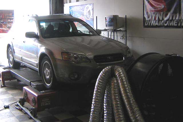

Posted 10 June 2006 - 06:43 AM
I've done a dyno run with my car and Regular. In another week or two I'm going back to do a run with Premium. I'm also going to do a run without any air cleaner.
The guy who runs the dyno predicts a 2-3 hp difference for Premium (we didn't get any codes showing retarded spark or detonation on the first run) and 1-2hp for the air cleaner, but I wanted objective data.

I've already done a dyno run with my car and Regular. In another week or two I'm going back to do a run with Premium - 93 Octane no less. I'm also going to do a run without any air cleaner.
The guy who runs the dyno predicts a 2-3 hp difference for Premium (we didn't get any codes showing retarded spark or detonation on the first run) and 1-2hp for the air cleaner, but I wanted objective data. To put it in perspective, that's about the difference from running your A/C (did runs with it on and off).
I've been switching fuel every 2,000 miles and I'm also going to do some acceleration tests with each fuel so that on-road performance is measured. I defy anyone to tell which fuel is in the car by driving it.

The ECU running regular, didn't do anything - it ran normally as far as I could tell. I'll know more after the next run but I predict the difference, if any, will be within the error of different runs on the dyno - a couple whp.
I went to TDC Tuning in Concord, NH (http://www.tdctuning.com/). I went there because he does a lot with turbo Subarus (he has a Legacy GT) and because it's probably the closest AWD dyno to any of our offices.
A session can cost from $75 to $150 depending on how many runs and what data or tuning you are looking for. Mine was the first H6 he'd ever run but he has run many Subaru turbos and sells tuning parts for them.
There are some other AWD dynos in New England. However the numbers from one dyno to another don't usually compare: some facilities are very optimistic, others are not.
