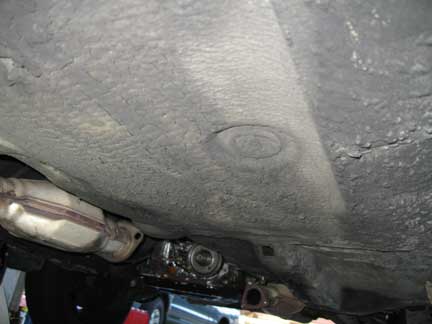

Here are the pics I took plus an eletric diagrams for a 92 subaru legacy tranny

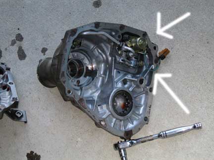

The housing you'll need to remove
Attached File  housing.jpg   15.38K   242 downloads

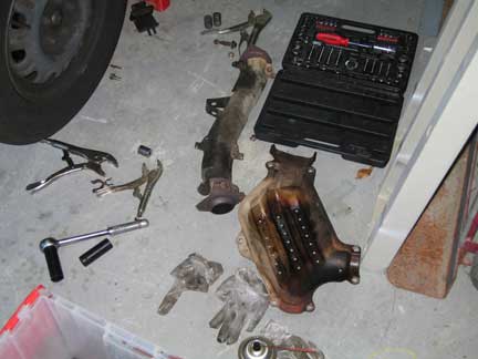

Under the car shot with stuff removed
Attached File  carriage.jpg   14.22K   248 downloads

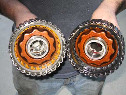

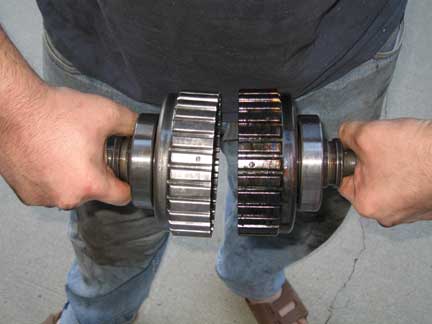

Big difference between the bad gear and good gear. On bad gear all clutches were welded together.
Attached File  gears-compare.jpg   14.61K   299 downloads

OK here is where the solenoid is
Attached File  solenoid.jpg   17.87K   236 downloads

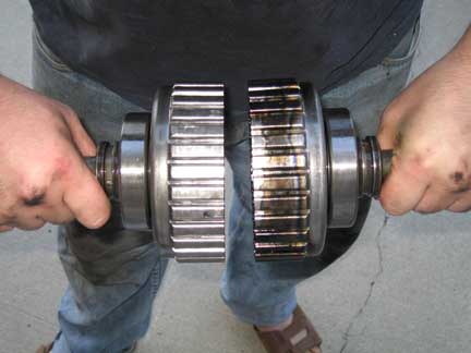

Good gear
Attached File  new-gear.jpg   17.85K   148 downloads

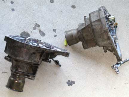

Some parts you are gonna take out
Attached File  parts.jpg   17.1K   194 downloads

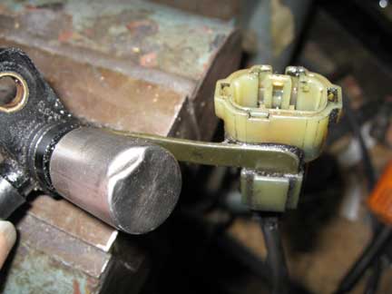

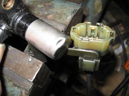

My bad sensor unit, somehow it got smashed up
Attached File  terminal.jpg   14.73K   181 downloads
