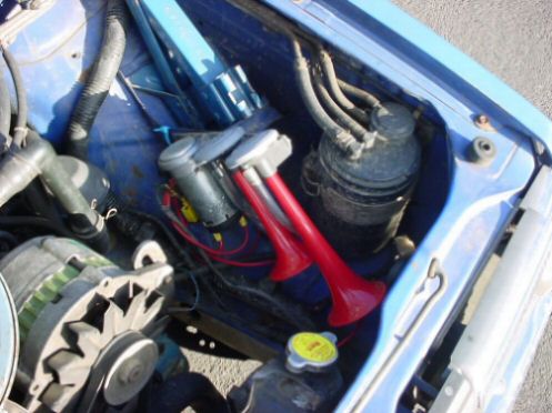

I quickly discovered it was the horn itself... my roommate had this laying around so I did this...

How do you rig something like that up?

You can buy aftermarket air horn kits. They usually contain a small electric compressor that you hook up with the wires that originally ran to the horns. The compressor then pumps air through the small air horns.

I took about 6" of mounting strip (strip metal with holes) and mounted each component in every 3rd hole or so... 2 horns the little electric compressor that runs them, and a relay...
ran a fused wire from the battery via the relay wired to the original horn wire...
blew the horn fuse in the dash once but got it on the 2nd try... (:
when I was getting parts I saw a horn kit just like this one for sale at Mike's Auto Parts on Woodstock and 52nd... didn't catch the price...
