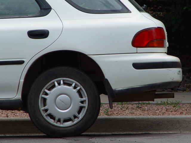

Nice! It looks lke youe got the same closeness in the rear as did I, but i still had the stock 175 70s on there... Looks good, I'm psyched to see real meat under it now...
OK, so question... How do you link/upload the pics to the message, rather than as attachments? I have to keep deleating my attached photos to bring more in....
here's pic of forester struts on legacy springs for the rear
(reference the previous posts to see stock and full forester parts vs. this, the final product)
I think the legacy springs mellowed out the rear such that it sits level with the front...
I know, i know with forester parts all around its higher with more clearance in the rear, but its not my car... So just the mellow 2 inches all areound is fine... but now i have rear forester springs sitting around, heh heh heh :brow: :headbang:

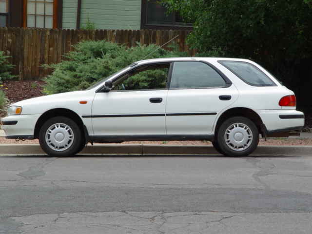

Yeah I swapped for shorter springs which let the tire go back a little...
http://www.ultimates....0&d=1150778988
should shows the tire close to the front (as is yours) with all forester parts...
i actually think my rear tire is sitting closer than yours. Its gonna be interesting fitting my SSR's.[/quote]
#40 superu
superu
    It's All We'll Drive
  • 811 posts
  • Moab
Posted 28 June 2006 - 11:09 AM
mine measured about 21" from bolt to bolt.
Hmm, I got about 20.5 bolt to bolt, straight line, although there is a slight curve in the arm...
Man, seems a little more complicated to get it just right than just swapping struts! ;)
All stock, I was at 6" rear diff to ground :mad:
all forester struts and springs i was at 10" rear diff to ground :headbang:
forester struts on legacy springs i am at 8" rear diff to ground :clap:
See previous post of IMP, LEG, FOR springs lined out
