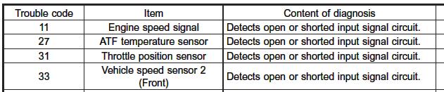

I put the AT light in diagnostic code output again, and now its spitting out code " 1long, 1long, 7 short" which means code 27.
What is code 27 for again?

Thanks for the codes again.
So, even after I replaced the temp sensor, I still get the code 27 which says defective temp sensor...
Does that mean its just a short in the wiring harness somewhere?
Yes, code 27 is saying that there is a problem with the wiring going to the sensor. It could be a short but more likely it is due to a bad connection somewhere.
