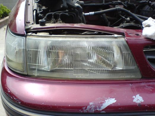

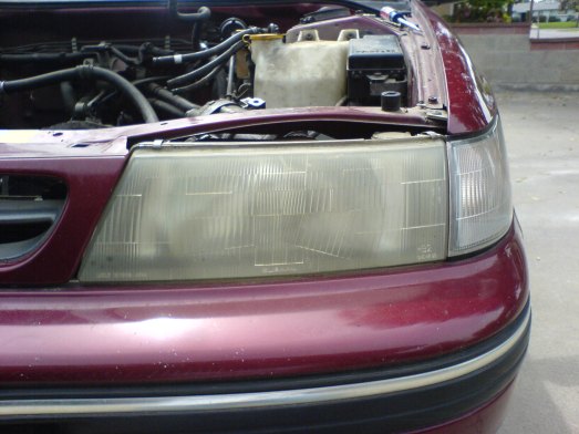

I know a lot of people have restored headlights different ways, and everyone has their own "best" way. I'm going to describe this process so that a newbie can do it, so forgive me if I state obvious things. Understand that this is simply one way to do this restoration and I will not pretend it's the best, it simply worked for me. Wetsanding/clear coating, toothpaste, brake fluid... all those other techniques exist and should be considered when deciding how you want to do your own headlights.
I began wetsanding the lens beginning with the 1000 grit. I sanded for 25-30 min. with this one alone, and kept sanding until every imperfection was gone and the lens was a very uniform matte finish. The time it takes to complete this step will vary based on how bad your headlights are. You can tell it's almost time to move to a smaller grit when the water coming from the area goes from a yellowy milky fluid to a brighter white, more transparent fluid. The spent about 5-10 mins each with the 1500 and 2000 grits, then spent another 20 mins or so with the 2500 grit going horizontally for a few minutes, then going vertically for another few mins. I gradually let up on the pressure, and made sure it was liberally lubricated with water. The result was that by the end, I was basically keeping only enough pressure on the sand paper to keep it against the lens, no more. You can tell that the lens is almost smooth enough when the water starts to bead up on the lens rather than appear to be absorbed.
After all the sanding was done, the headlights should look acceptably clear. That way, they'll be like glass when you polish them. Now it's polish time... it's basically like waxing a car, although I tried to press pretty hard on mine to really work out a good shine. I polished for about 10 mins each headlight, going over it once, buffing, then going over it again, and buffing. This whole sanding and polishing process took about 3 hours for both lights. The end result on the passenger side light, the same one pictured above, was this:
Posted Image
I was very happy with the results. Here is another pic of the driver side headlight completed before I had begun on the passenger side- this is a good side-by-side comparison:
Posted Image
And here Is the end result after both headlights were finished:
Posted Image

1. Nice writeup! And nice pics too.
2. On technical note - with that amount of cloudiness I'd start with 800, or even 600 grit.
2. Since you sanded your headlights on the car, I don't see what stopped you from applying clearcoat, all you need is some painter's tape. It would have saved you quite a bit of time also, since you wouldn't have had to make it mirror-like with sandpaper, clearcoat would have nicely filled the scratches left with 1500/2000 grit paper. And it would also stop the yellowing from coming back for quite a while.
