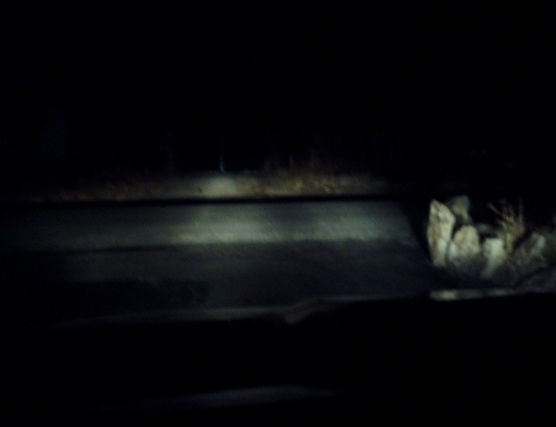

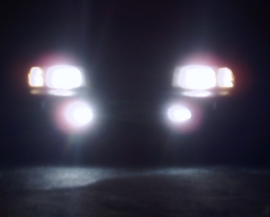

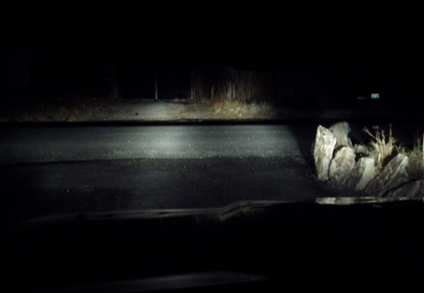

Have before and after pics. Not a great difference in the pictures as far as beam pattern, but the light reaches further instead of wider and the silverstars are much brighter. First one is with the 9004, second is with the 9007 and I included a front shot of my Loyale with the driving lights on just cause I could.

my stock headlights look just fine, as good as your "after" photo.. I cant believe what I am saying, myself, but thats what the photo makes me think..

There's quite a bit more light than the photos show. This all started cause I had to get a new bulb anyway so why not find something slightly better to install instead.
