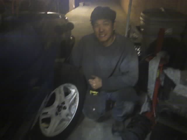

s'ko Posted March 2, 2007 Share Posted March 2, 2007 I am almost done with my lift. The BRAT looks mean. It’s sitting on 225/75/16 or 29x8.8/16. The back bumper sits 39 inches off of the ground. But the center differential is about 10 inches. I used 5X2 square tubing to make the lift. The diff hanger I welded a piece of metal plate and dropped it 5 inches. What else can do to get more clearance in the middle? Here is a really bad cell phone camera picture of the wheel. BW Quote Link to comment Share on other sites More sharing options...
Scott in Bellingham Posted March 2, 2007 Share Posted March 2, 2007 pictures, on the EA81 you dont want more then a 1" over stock angle on those axles its the weak link ,in my opinion Quote Link to comment Share on other sites More sharing options...
s'ko Posted March 2, 2007 Author Share Posted March 2, 2007 yeah I forgot my camera at work. I was jumping like an idiot last night when I got the wheels to fit. The lift blocks for the rear are the same height as the front blocks. I might take them down and lower chop it by an inch. That should move things up. I did the rear diff hanger like this http://i81.photobucket.com/albums/j208/boswan/diffhanger.jpg I also noticed that it's not all bolted up tightly. I will probably get about and inch or two when it's all secure. Will take better pictures this weekend. BW Quote Link to comment Share on other sites More sharing options...
