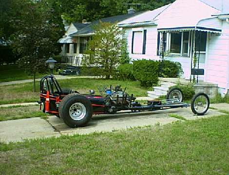

Posted 17 April 2007 - 12:07 AM
If'n ya never dragged it, how'd ya come up with that thar "14 second" figure, fella?
:confused:
Actually, I agree with you..going around curves is way more fun than drag racing, but the stuff I attack the twisties with only comes with two wheels and a set of handlebars..however, if you've never driven something that'll do 150+ mph in the quarter, you have NO IDEA of the skills involved in that little bit of straight line driving. Add the joy of having a potential bomb disguised as a transmission sitting 'twixt your legs while your crotch nestles up against a differential and a pair of drag slicks wanna rub elbows (literally) with you, front wheels that'd look at home on a kids BMX bike (minus the brakes), and it makes for a whole different sort of challenge. If'n I can't find my penis, it's just 'cuz it crawled back inside out of sheer terror..
:headbang:
Just to give ya an idea of what it feels like, here's a pic of my old office, and one of the whole car..(things got much more "finished" than in these pics..they were taken the day I bought the car. It looked as though it was originally built by someone who subscribed to your belief in Home Depot..took about a year & a half of nights & weekends working before I felt it was "safe.")
Howzat for chest-beating?
:banana:
While all this penis-waving is sorta fun & all, it doesn't change the fact that threaded rod really doesn't belong on an automotive engine, or that a tap isn't a reamer.
