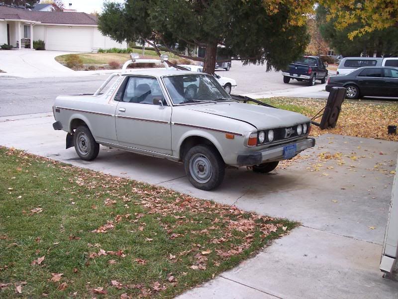

Posted 27 August 2010 - 11:15 PM
Posted Image
This was from like 6 months ago. It now has a engine in it and it has enkeis on it. The interior is torn apart. The dash is sitting in the passengers seat. I need a new dash. Something that does not have holes cut in it would be nice. But it runs. Runs pretty good actually. Just rebuilt the carb on Monday. Needed to help that fresh rebuilt EA-71 to go down the road better.

Posted 27 August 2010 - 11:26 PM
Very nice... Looks solid!!!:slobber:
