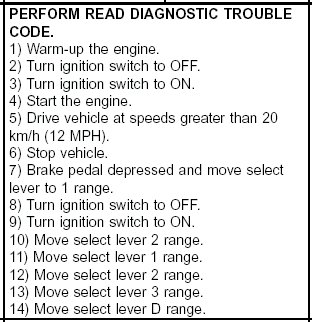

Follow the procedure as in the attached chart. The light should blink -- it might be eight times per second, four times per second, or a series of long and short blinks. Make a note of the result, and get back with that info.

Posted 25 April 2008 - 05:21 PM
Okay....4 longs, 5 shorts. So the code is 45.

Posted 25 April 2008 - 05:46 PM
Code 45: Intake Manifold Pressure Signal
Diagnosis: Input signal circuit of TCM from ECM is open or shorted
Trouble Symptom: Excessive shift shock
However, the first step in the diagnostic procedure for code 45 directs you to the diagnostic for the TPS, which includes the symptom of excessive tight corner "braking".
Unfortunately, there's too much to post here. Okay if I send a PM to you with further info, anspaugh777?
