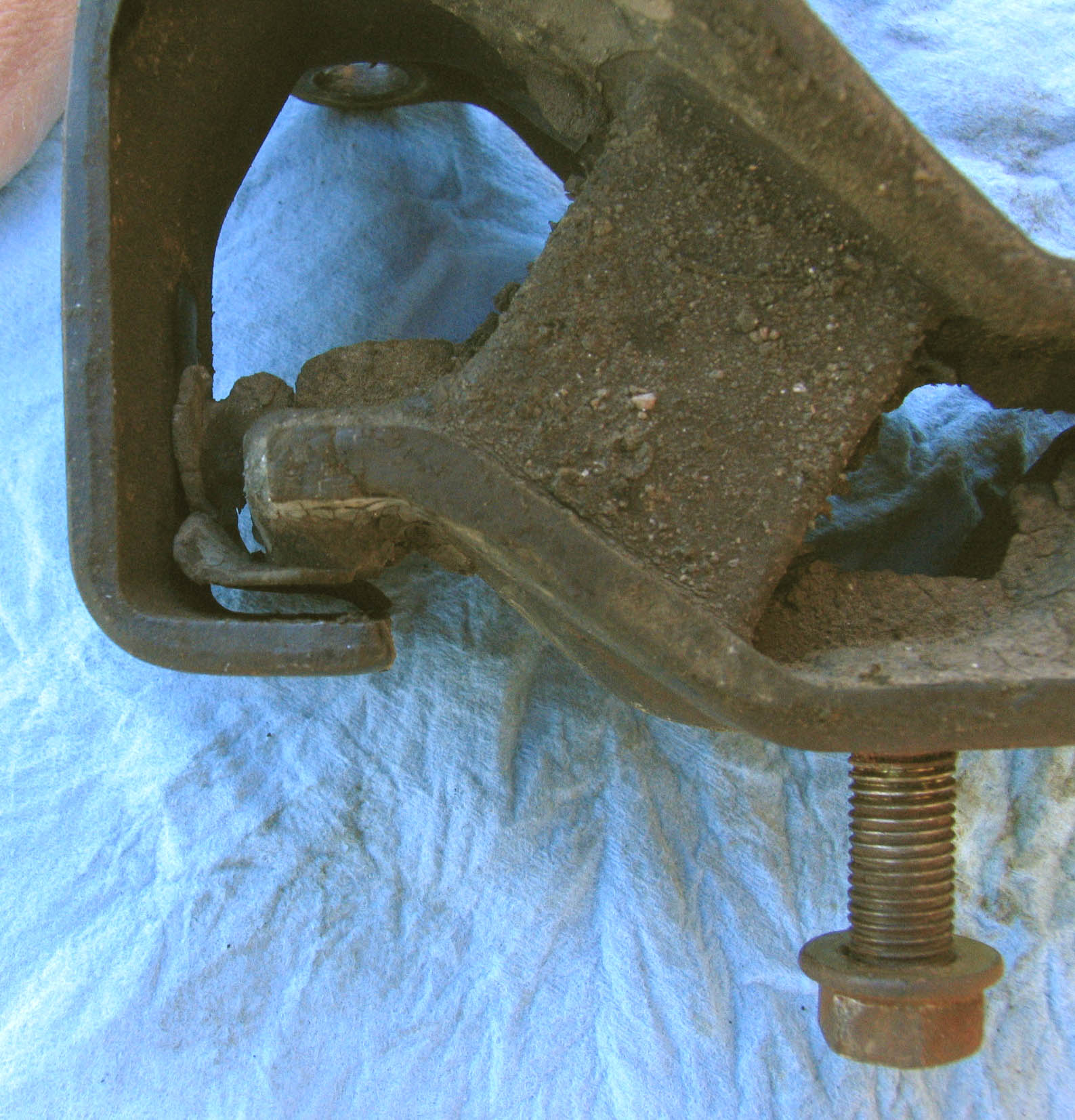

Here's an update. I inspected the engine and transmission mounts this morning. They definitely look like 174K parts, but I'm not sure if I need to replace them. I pulled the tranny anyway, and the main shaft moves 10mm fore/aft and radially, so the tranny was the source of my noise and definitely needs to be rebuilt/replaced.
I'm debating whether or not to replace the engine and tranny mounts. They all have the thinnest rubber piece separated from the steel. Below is a pic of the tranny mount (the engine mounts have a similar problem). Look at the air gap between the lower steel bracket and the thin rubber piece in the lower left of the pic:
Posted Image
I think that gap is not supposed to be there (the rubber should be bonded to both the top piece of steel and the bottom piece of steel?). I'm think that without that bond, the engine and tranny can move fore/aft more easily than they should, which I assume puts stress on many parts.

The gap in the mount that you are refering to is normal. Only the large square block of rubber is suposed to be bonded. As long as the rubber in the mount is not oil soaked a mushy, or rock hard, I don't see any reason to replace.
I have had to replace a lot of auto trans. mounts due to seperation of the rubber from the steel, but have not seen it with maunal trans. mounts.
I would recommend sorceing a used transmission.
Subaru transmissions are expensive to rebuild right. The only sorce for parts is SUBARU. No after market support that I have found.
