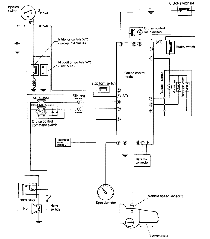

snip snip. The closest I have is for a '96 2.2L, but if it's the same, probably cutting wire 3 at the cruise unit might be the easiest access point?

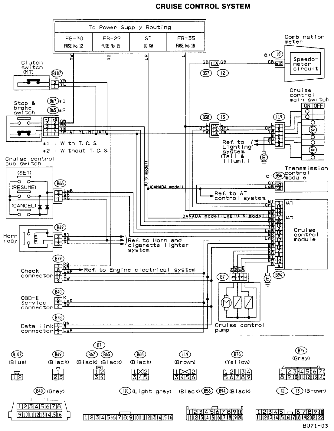

Hm....good question, where is the module....(again this is for '96 legacy) Sorry the wiring one is so big but I didn't want to downsize it as there is so much detail.

Porcupine - great pictures boss, those are helpful. I have a cc issue with a 96 Legacy LSi and only have 95 Legacy and 97 Impreza FSM's which are different than what you posted.
For the purpose of this discussion I did an EJ25 to EJ22 swap and don't know where to connect the vacuum hose for the pump to. I connected it straight to vacuum and it just makes the car rev to 6,000 RPM.
So there must be something to "control" this vacuum? I don't see it on the FSM pic's and don't understand how CC works.
