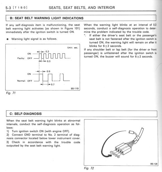

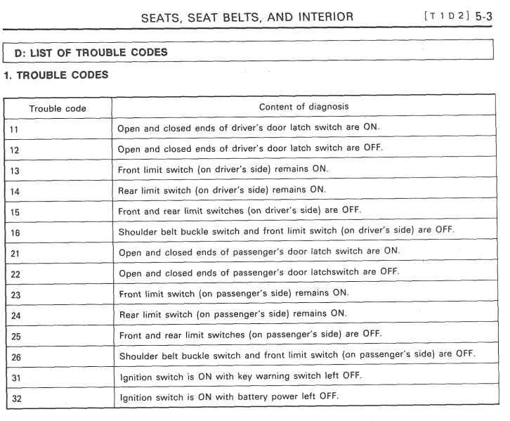

SevenSisters Posted December 21, 2003 Share Posted December 21, 2003 If you bought your car new, you probably paid a couple of hundred dollars above what a simple, manual 3 point seatbelt system would have cost because someone mandated an automatic system to keep us safe. I had the same type of problem and fiddled with the switches until it worked. It was just an adjustment but I can't remember which switch was the culprit. Here are the components that replaced the manual system: ignition switch door lock switch front limit switch rear limit switch 2 relays CPU CEL trouble code indicator (that right, it's so simple you need help from the computer to fix it) Start with a diagnostic. I've tried to attach the codes. Good Luck Quote Link to comment Share on other sites More sharing options...
SevenSisters Posted December 21, 2003 Share Posted December 21, 2003 Now I remember why I was so pissed when I had to fix mine. My FSM has some duplicate pages and is missing some that are needed. Here's a little more info. Maybe someone else can help too. Quote Link to comment Share on other sites More sharing options...
