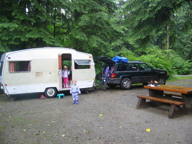

"Small trailers, pulled by small cars, really don't mix. I don't recommend it. I'd really advise going another way than in a hardshell trailer. "
While I agree with you for the most part, towing a trailer with a small car is normal in other parts of the world....
Check out...
http://www.bbc.co.uk/topgear/
then click on
-watch videos
-mucking about
-TG goes caravanning
I have a 1972 Sprite Musketeer (about 15 feet long and 1200 lbs) empty. It's a small Britsh travel trailer and when I bought it, a British friend of mine told me these are normally towed by " big cars" like my Legacy.
I haven't tried it because I don't have a hitch on the Legacy, I also have a Grand Cherokee 4.0 and because I live in British Columbia where every road out of town leads to climbing a high mountain pass.
If I were going to tow with the Legacy, I would stick with a pop up like the coleman. On windy days, even the Grand Cherokee stuggles with our trailer. Head winds make it hard to maintain speed and cross winds jerk the truck around.
Good luck and have fun!
