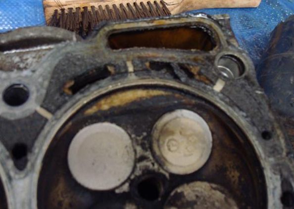

msmithmmx Posted May 8, 2008 Author Share Posted May 8, 2008 I picked up a 30 inch pipe, came off with a little effort. I think I found the problem.... Quote Link to comment Share on other sites More sharing options...
