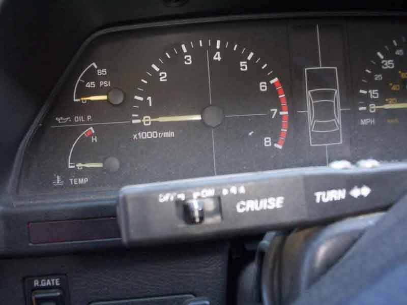

Cruise Control switch, (usually it's in with the turnsignal lever),

The control on/off switch - in pod to left of gauge cluster
The set/resume switch - steering wheel horn pad
