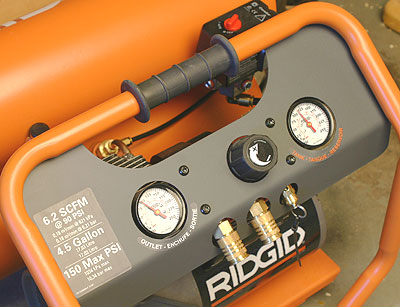

looks like I'm checking CL now... my compressor finally gave out on me. won't even turn on. it tries, and immediately blows a fuse...
it's a Coleman. oil-less, and was loud as hell :lol:
Posted Image
I was trying to use it to pull the wheels off my wagon, but I tried my Craftsman 1/2" 19.2V impact... worked nicely!
But I still have a twin tank Ridgid compressor like this one I can use for now
Posted Image
anyone ever reused the tank and put a different compressor on it?

Posted 11 July 2010 - 12:29 PM
Yes, I've transplanted an air head. :)
Works great. At some point I'm going to have to do it again.

I replaced the compresser on the one in our farm shop a year ago with the twin cly. job harbor fright sells works great only cost me $89 bucks too 12.5 cfm @ 125psi

Being as I used to build and rebuild compressors for a living - yeah I suppose I've done that a few times :lol:
On your old compressor - have you done any troubleshooting? It might be something simple like a start capacitor, etc.
If you can turn the air-end over by hand try taking the belt off and seeing if the motor turns over. If it does try spinning the motor as quickly as you can by hand and then simutaneously turning on the power. If the motor spins up that way but won't on it's own (or won't under a load) it could easily be the start cap has blown out.
If you do end up buying another machine - just strip the motor and air-end off the old tank and plumb it into the new machine with hard pipe or SS flex line. More storage capacity won't hurt you any. No sense throwing away an extra 20 gallons of air storage.
