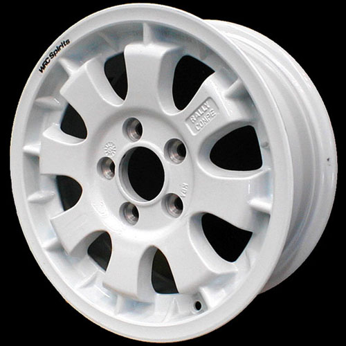

Hey all,
I have a set of these on my rally car, just got them a month ago. They are ex-factory rims used so I am told by Possum Bourne many years ago. The ones in the pic have the wrong stud pattern, but are th esame as the ones on my car (I don't have a pic of mine). They are Enkei WRC Spirits...14 x 6in. They are awesome!!!

Thats very informative! I wonder if copper head gaskets might help with your overheating problems. Just a thought, but anyway, do you have any more pics of the car, other than what is on the site's season photos? Id also be interested in some video if you can swing it!
PS do you know how many sets of those WRC wheels that japanese company has?

carfreak, sorry, they are as rare as hens teeth, it has taken me 12months to track thse ones down, andmore people here are building rally Leones, so they demand is higher, and they are even harder to find now...like you say..blast, cause they are great looking alloys.

sorry, that was from another place (got myself mixed up a bit), these have the right stud pattern (4x140), you could try emailing them, I have tried but not heard anything back from them.
PCD is the stud pattern if I am correct.
