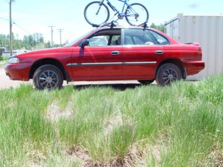

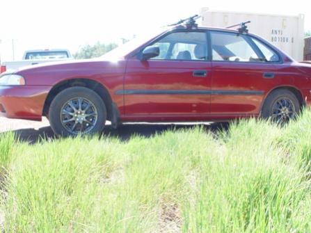

superu Posted December 15, 2008 Share Posted December 15, 2008 And here's how it started! Quote Link to comment Share on other sites More sharing options...
dirtygst Posted December 15, 2008 Author Share Posted December 15, 2008 wow thats a pretty big change! i was worried that it wouldnt give that much but with those a/t its looking right where i want it. right now im getting parts for my h6 swap and hopefully picking up the springs this week and have it all done by the new year. then ill need to save up for some new wheels and tires and its on. well thanks alot for those pics its exactly where i was hoping it would be. Quote Link to comment Share on other sites More sharing options...

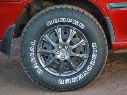

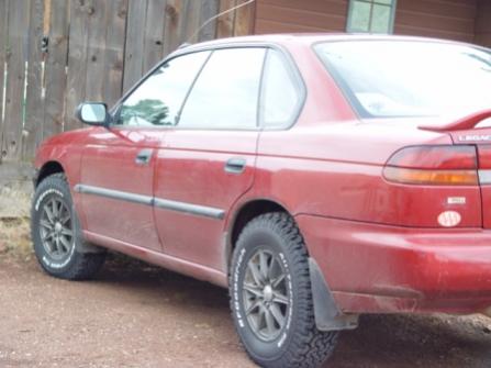

superu Posted December 16, 2008 Share Posted December 16, 2008 superu... are you just on the outback struts/springs or do you have the king springs too? looks like it sits higher than my wagon did (maybe due to the weight of the sedan vs. the wagon?) Strat, Stock 98 OB struts and coils. The first pic witht he struts (shows hubcaps too) is with the stock (185x70?x14) tires (a 24" tire).... Then the close up (also with wheel covers) is 205x75x14 (about 28") all terrains (cooper discoverer's, car tire), then the BFGs on a rim is the 27.5x8x14... I am thinking about lift springs though... My front bumper is a touch heavier than stock Quote Link to comment Share on other sites More sharing options...
