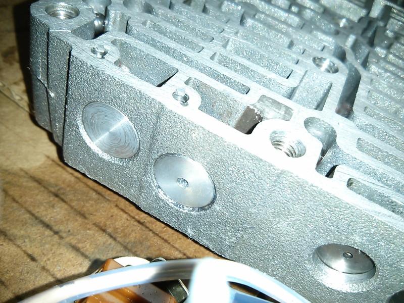

Now for an update:
I upgraded the trans recently with 4.11s, high stall torque converter, and valve body mods for improved shifting. It's awesome. The trans just clicks through the gears with no hesitation, the car lunges forward on the shift to 2nd.
One previous limitation of the paddle shifters was engine braking in 1st gear.  Depending on the selector position it would either have gears 1-4 and no engine braking in 1st or it would have gears 1-3 and engine braking in 1st. I sought to remove the limitation above and after poring over the diagrams I've done it by modifying the "overrunning clutch control valve".  By blocking off the "1st reducing pressure" port and also providing a bleed, it is now possible to select gears 1-4 when the selector is in the "2" position; this also provides engine braking in 1st gear by engaging the low clutch.
Yes, that's JB Weld in the valve body passage.  :P   The end plug also has a small hole drilled in it.
